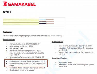

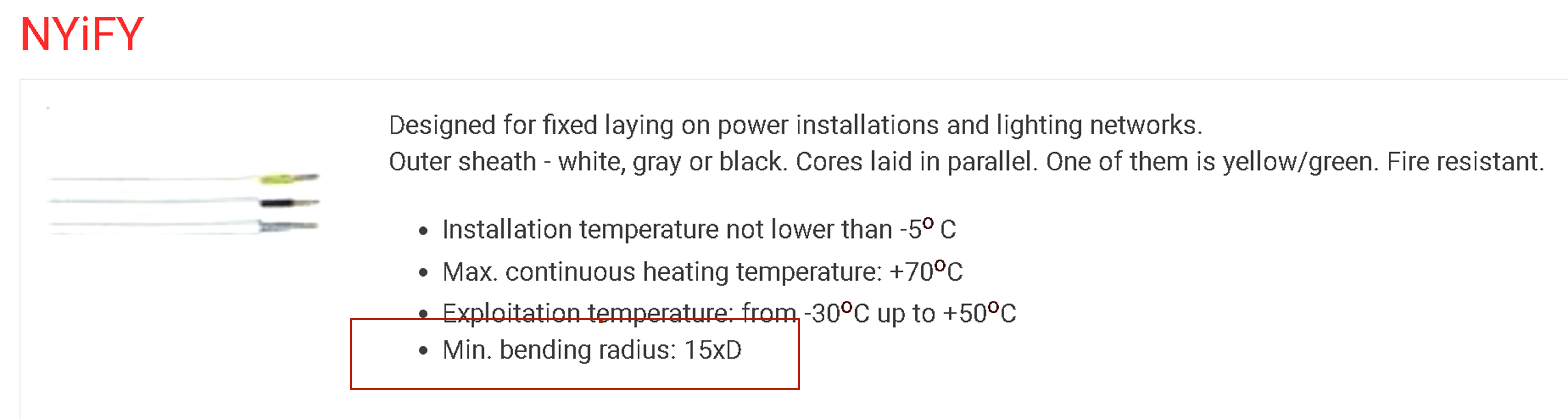

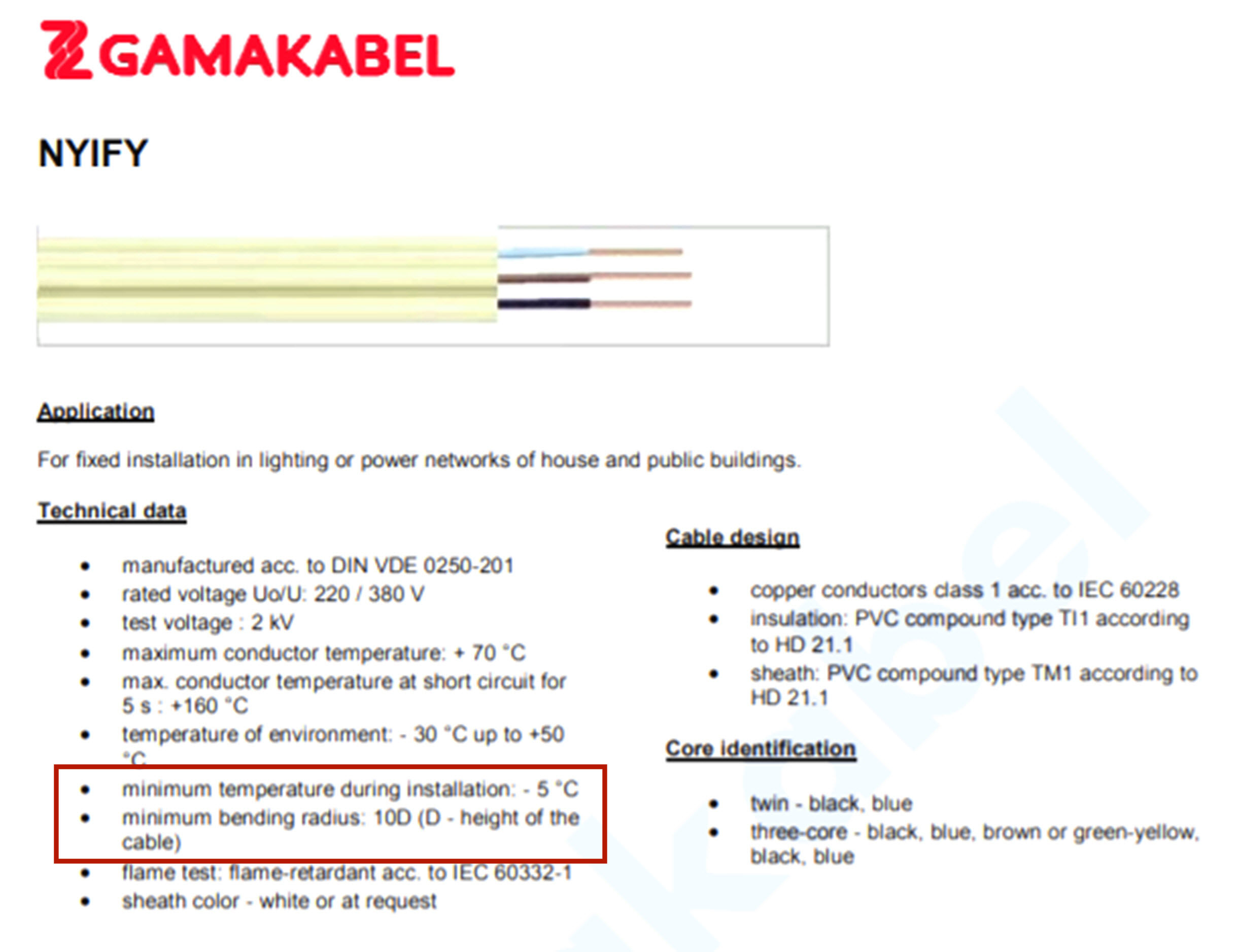

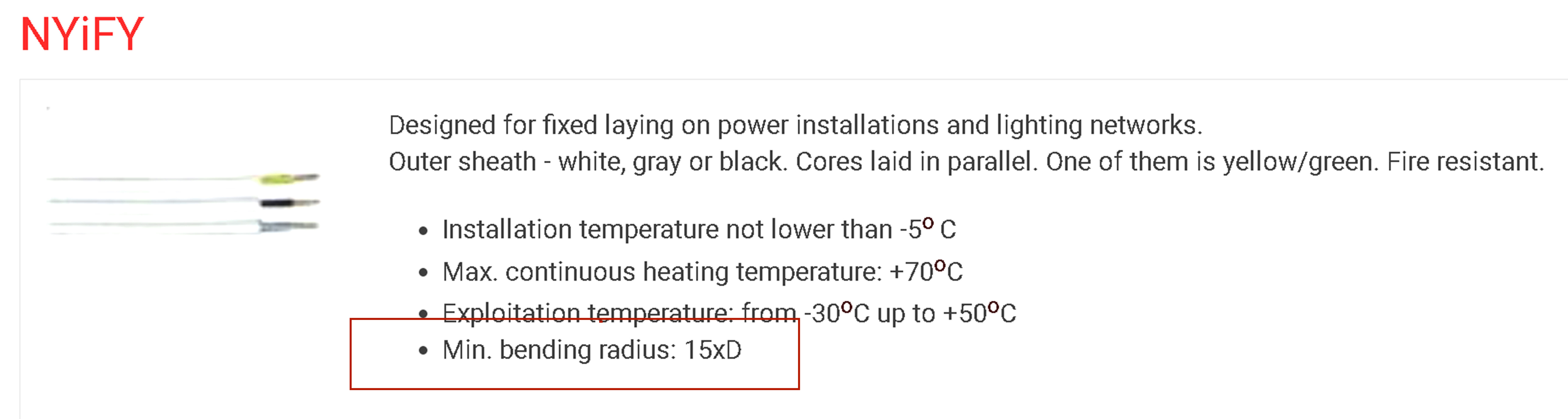

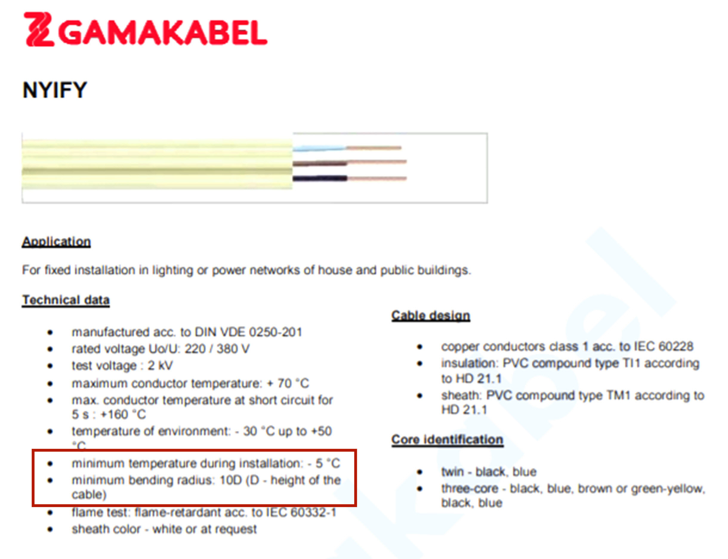

Защо ги лъжете хората?
Каква е целта?
Мостов кабел се огъва на тясната страна
10D, на широката 15D.
нед май 12, 2024 2:42 pmBLUEPUPIL написа:
Няма да думкате на хората мостоваци, огънати на по-малко от 10D (D=размера(ширината) на по-тясната страна) и 15D (D=размера(ширината) на по-широката страна) [от
напречното сечение], което е абсолютния минимум за топ quality шнурове, по-добре (като знам колко ви е акъла и с какви шнурове работите) да качите тези числа нагоре.
How to apply a bending radius correctly?
Cables can be bent, that goes without saying. But if you bend a cable too far, this considerably shortens the lifespan of your cable and you even risk short circuiting and/or causing a fire. On the outside of the bend you have after all 'stretched out' the cable materials too much - they become thinner or perhaps even show cracks - as a result of which the original electrical properties of the conductor insulation are lost.
So, how do you do it safely?
What is the bending radius of a cable?
The bending radius expresses the smallest possible bend with which one can safely bend a cable without kinking it, damaging it or shortening its life span. The smaller the bending radius, the shorter bends you can make.
The bending radius is usually expressed as a multiple of the outer diameter of the cable, for example: 10xD or 15xD where "D" is the outer diameter of the cable. Sometimes this is already calculated specifically for your cable and is then expressed as a value in mm. Bending radii vary according to the type of cable and the section. The bending radius that applies to a cable is stated in its technical data sheet.
The bending radii stated always apply at an ambient temperature of (20 ± 10)°C and are always measured at the inner curvature of the cable.
How to correctly apply the bending radius?
The cable should be bent around an imaginary circle whose radius is at least the bending radius of your cable.
How to calculate the bending radius of a section?
Singe-time bending
For unarmed cables, a reduction of the bending radius by 50% is allowed by the construction standards during installation under the following conditions:
by a skilled worker
single-time bending
the cable is heated up to 30°C
and cable is bent by means of a template
Can I have my cable follow the angle between the wall and ceiling?
Yes, but only if you respect the bending radius properly. Your cable will then bridge the angle between wall and ceiling. It is not permitted to push the cable as far as possible into the corner to get as little as possible away from the wall and ceiling. What you are doing then is applying a much smaller bending radius than permitted.

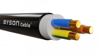

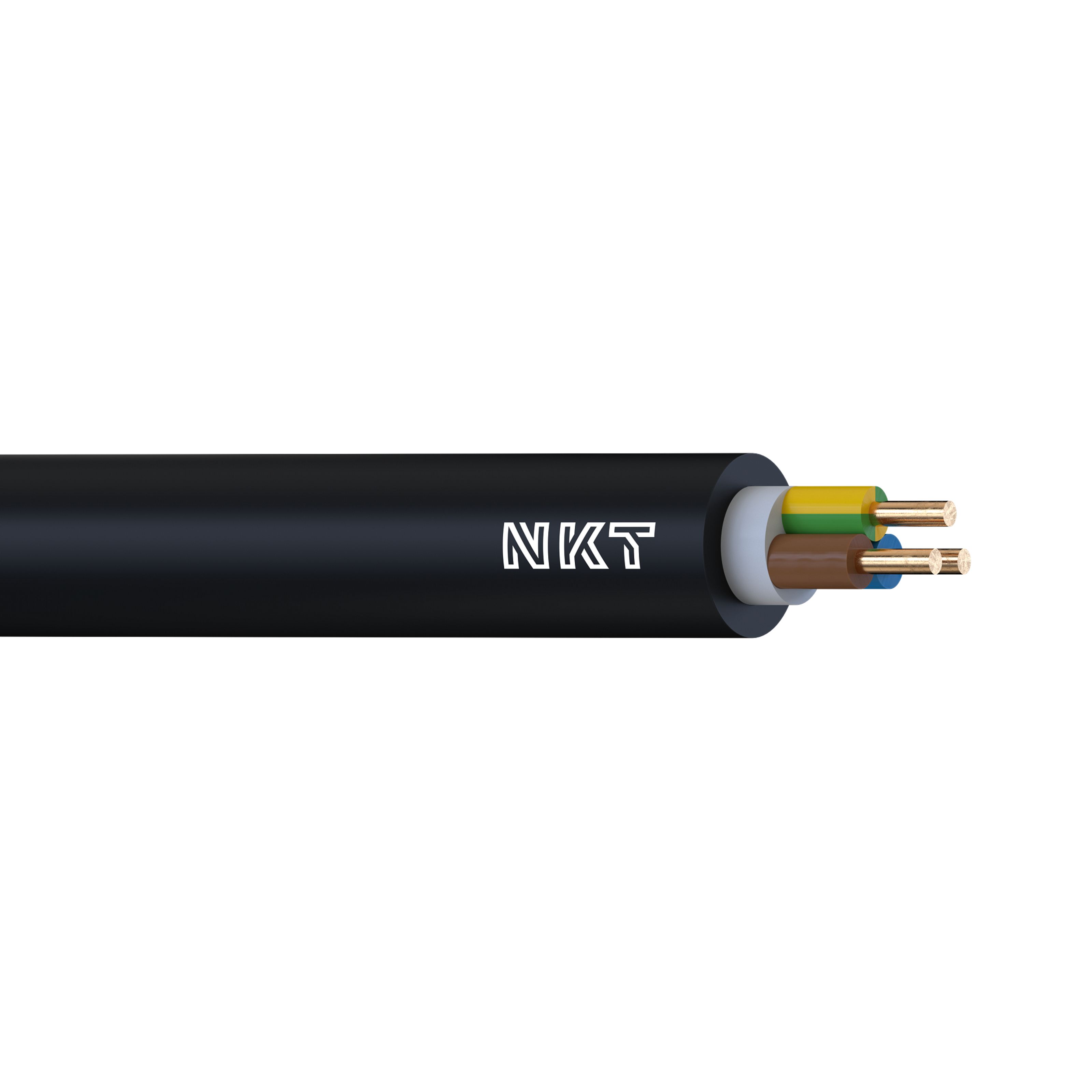

Показаното на снимката огъване е недопустимо
и е в разрез с EN, DIN, VDE, защото поврежда
изолацията. Надупчените с пирони кабели се
свалят и се бракуват с протокол.
С думи прости, ако някой си позволи да направи
такава глупост, му показвате вратата,
документирате със снимки цялата простотия и
ако имате нерви си търсите парите по съдебен
път.
Това е и причината употребата на мостовак да
намалява значително в цяла Европа.
Не позволявайте на неграмотници да работят с
мостов кабел. Вече казахме, че безопасните
варианти за вашите финанси са два.

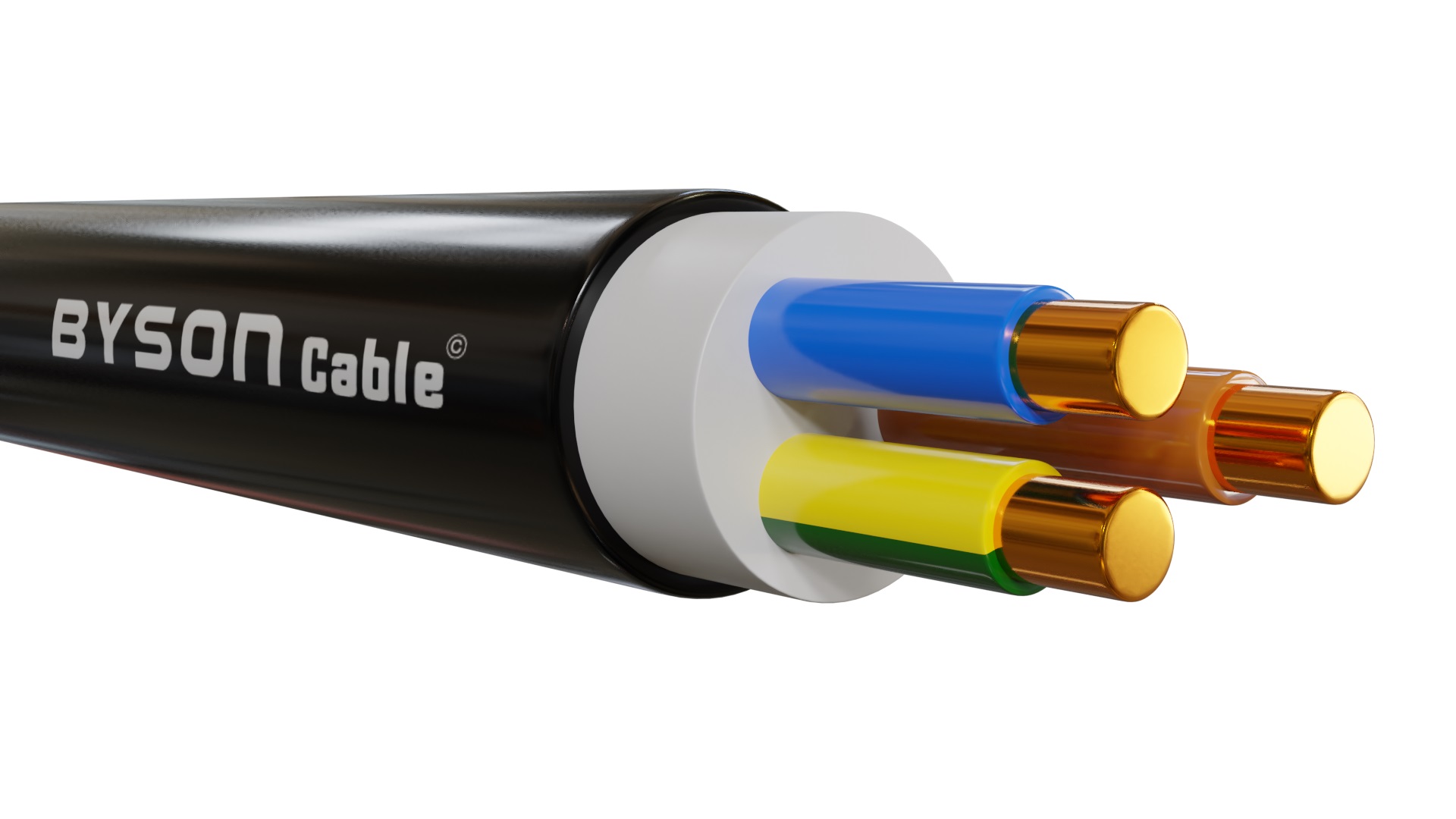

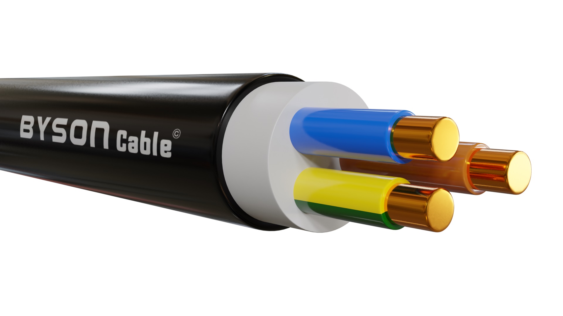

1..NYY (NYY-O; NYY-J) радиус на огъване за
целия кабел 12D, радиус на огъване на
изолираните индивидуални жила с отстранена
външна изолация и защитени в кутии 5D.

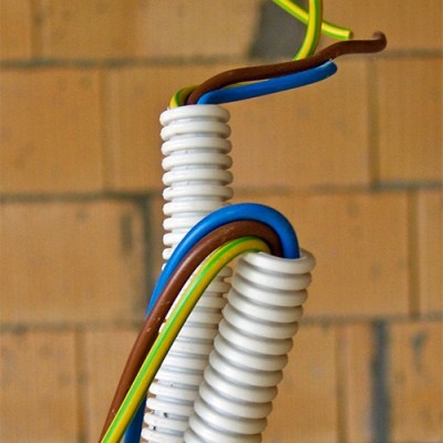

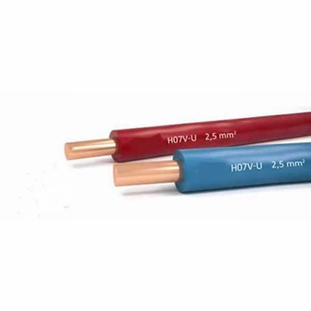

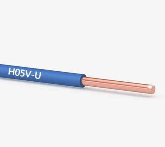

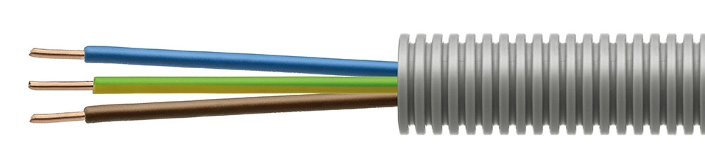

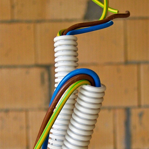

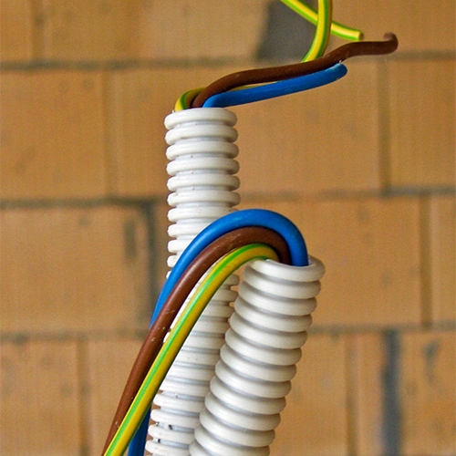

2..H05V-U / H07V-U (ПВ-А1) радиус на огъване
5D, извън кутиите винаги в гофре или тръби.
Изключително подходящ вариант, ако ви се
паднат електричари с гумени глави. Радиусът
на огъване на гофрето (без срязване),
практически не позволя увреждане на
изолацията на проводниците в него, при
условие, че отговаря на нормите и ако не е
огънато, така, че да се наруши структурата
му от пръстени.
BLUEPUPIL - майстор

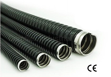

Следващо ниво е метално гофре с PVC покритие.

ср юни 26, 2024 3:34 pmiliya_i написа:
Аре спри да мъкнеш боклучави снимки, дето не знаеш от къде са и за къде са.
Боклукчави са кабелите от Азия, които
слагате на доверчивите клиенти.
Този кабел е един от най-качествените
под слънцето. Ама гроздето кисело.
