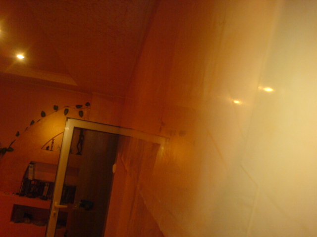

mnogo dobre si stava venecianskata mazilka s artestuk zimash si i ..cera rafaelo.. ot OIKOS I SI STAVA VENECIANSKA MAZILKA AZ SI NAPRAVIH CELIA APARTAMENT TAKA
