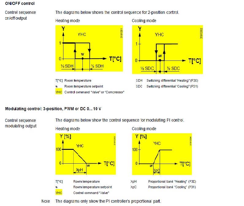

Картинка за сравнение с ON/OFF режима:
Ето малко от оригинала:
This function is available with RDG100, RDG100T and RDG100T/H only.
The demand calculated by PI control from the current room temperature and setpoint
is provided via Y1 and Y3 to the valve actuator as a PWM signal (pulse width
modulation) for thermal actuators. The output is activated for a period proportional
to the heating / cooling demand and then switched off for the rest of the PWM
interval.
The interval is 150 seconds (factory setting). It can be adjusted via parameters
P44 (Y1) or P45 (Y3). These parameters are only visible if 2-position is selected via
DIP switches 4 and 5 and if PWM is selected via P46 and P47.
For PWM, the integral time (P35) must be set to 0.
For thermal valve actuators, set the running time to 240 seconds.
• Never apply PWM to an electromotoric actuator
